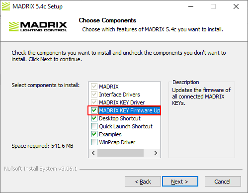

Issue:
MADRIX 5 will start in Demo Mode although a valid MADRIX 5 KEY (including installed MADRIX 5 license) is connected to the PC.
The reason for the issue:
The MADRIX KEY Firmware version is too old.
How to solve it?
- Please Connect the desired MADRIX 5 KEY
- Please start the installation file of the MADRIX 5 software again and activate "MADRIX KEY Firmware Update" at the "Choose Components" page of the Setup.
Important information:
Please disconnect all third party license dongles before you start the installation of MADRIX 5 again.
