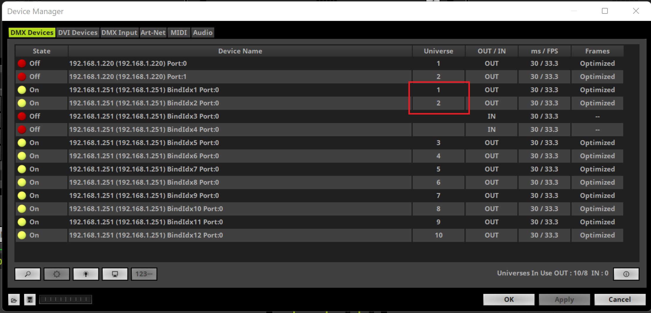

Hi Im having an issue wherby im recording from Madrix and i can see the AURA recording (blinking red) and also can see the recording in the AURA but when i play the recording the output is blank. I havent used an Aura for a while and must be doing something wrong. please see attached images/ tabs in Madrix and the Aura, can you please assist - the fittings / scenes are all on Universe 5.

I assume you also patched the fixtures in MADRIX starting with universe 5. Correct?
If yes, you just need to change the virtual universes to be recorded in the "DMX Devices " tab. For now you are recording universe 1 and 2. Please have a look at the attached screenshot.

Thanks Schulze, yes patch is universe 5. Just checking with the virtual universe i check both ports to 5? Also might be a silly question but im using an Aura 2, can you explain why we see / how we use the 10 out ports and 2 in ports?

Hi Quinton,
Yes, if you want to record Universe 5 for both ports. Just perform a double click on the Universe column and enter 5.
