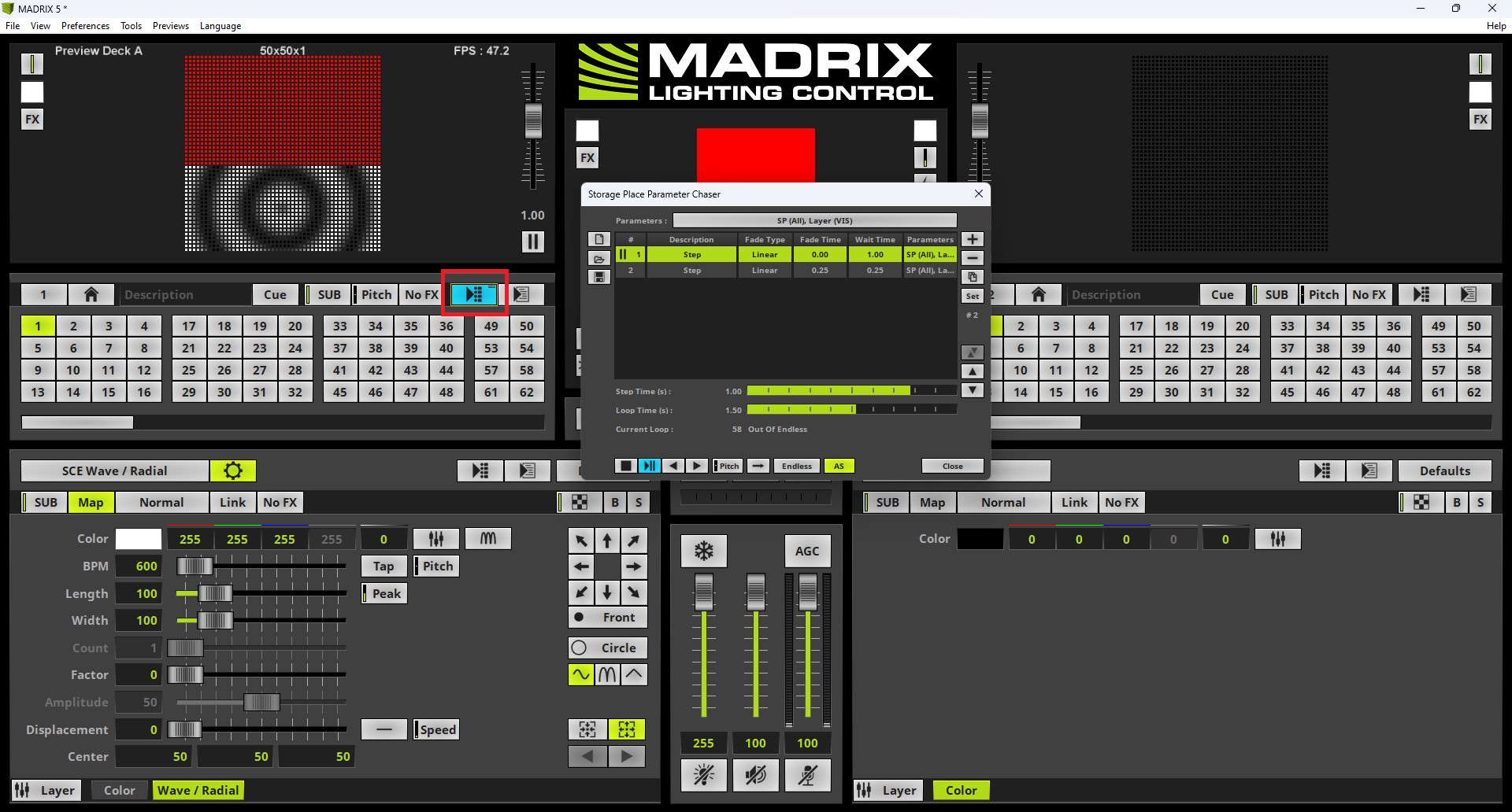

To get it working you will need to use a "Storage Place Parameter Chaser" instead of the "Effect Parameter Chaser". You will find it right above the Storage Places (see image below). You can use the same steps as you did before.
- Storage Place Parameter Chaser.png (238.25 KiB) Viewed 4518 times
