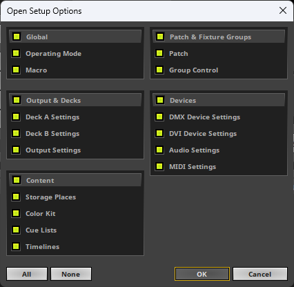

Hi Max X,
Please double check if all checkboxes are enabled in the "Open Setup Options", when loading the setup.
The DMX remote configuration as well as the Patch are part of the setup.
- Open_Setup_Options.png (17.33 KiB) Viewed 4938 times

Hi Schulze,
Yes, I load the setup normally (all boxes included), but almost everytime my custom personality just doesn’t load and everytime I need to reload this personality by myself (choose DMX IN device, check “remote” box in DMX IN tab ecc)
