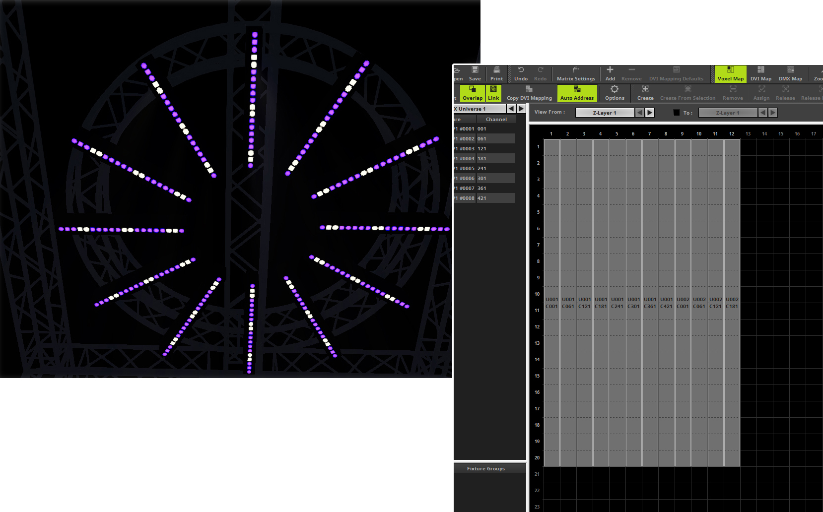

For the explained project I recommend for the MADRIX patch to unfold the Stars into a 2D linear assignemt and patch this one. Now you only to pay attention about the orientation per fixture. It is recommended to have the first pixel of the fixtures always on top or bottom.
After creating the patch you are still able to create cool content. But the MADRIX preview can now be used as technical preview to see how the effect is looking.
Perhaps the following image will help you to understand it better:
