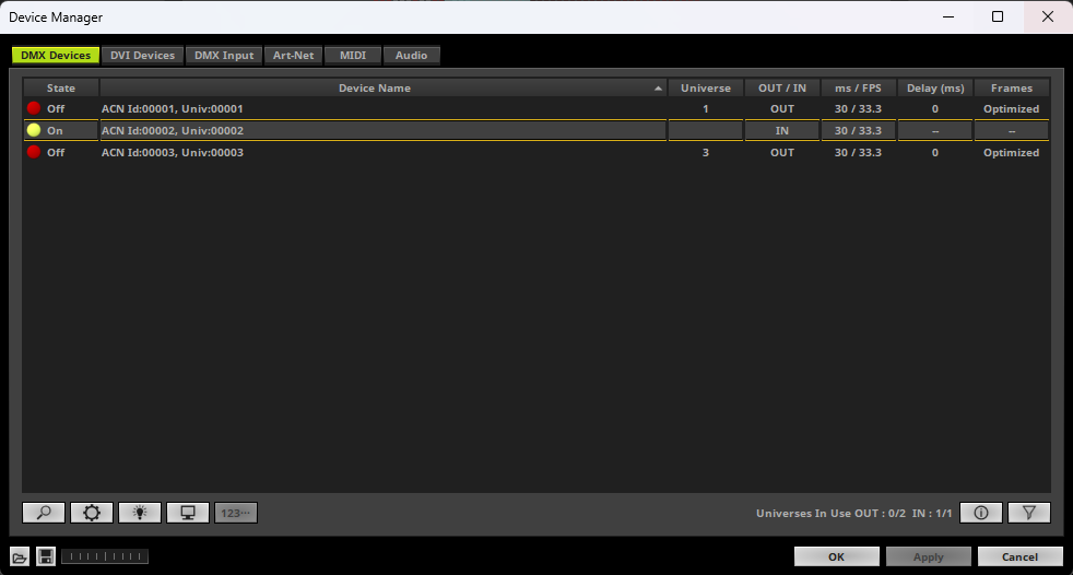

Device Manager for DMX Devices (tutorials said to go there) noting shows up as On. I can manually turn the State of the second device to On and set it to IN. Double clicking on the Details shows the correct Unicast IP. Device Name is ACN Id:00002, Unive:00002

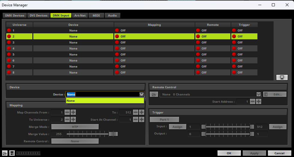

Did you select the sACN device in the "DMX Input" tab?
If not, please navigate to "Preferences" > "Device Manager..." > "DMX Input", click at one of the input universes and select the sACN device. Now you should be able to see incoming sACN data in the DMX Watcher.

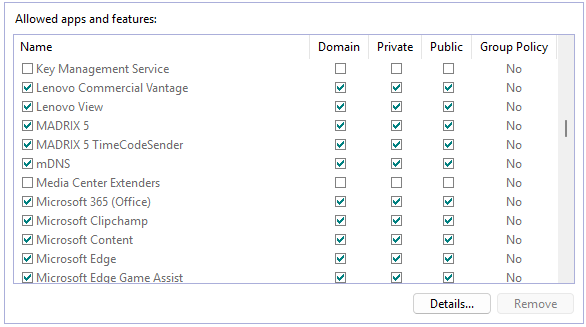

I am unable to see the sACN device. In the Devices Network tab I have Streaming ACN selected and the correct IP address selected from the pull-down menu. Windows Defender doesn't have anything blocking it, and my IT folks made sure there wasn't any other firewalls blocking traffic. I turned on the State for U2 to On, but the Device Name seems so just be a generic name.
